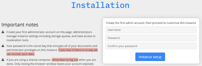

Once CryptPad is installed, use the URL with the token generated when you ran the server for the first time to start the onboarding workflow.
First, create your administrator account.
../_images/instance_setup_admin.png

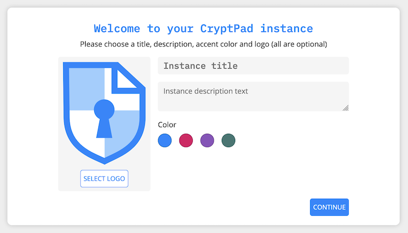

Then you can add a logo of your choice (200KB maximum size), change the instance title, description and choose an accent color.
../_images/instance_setup_customize.png

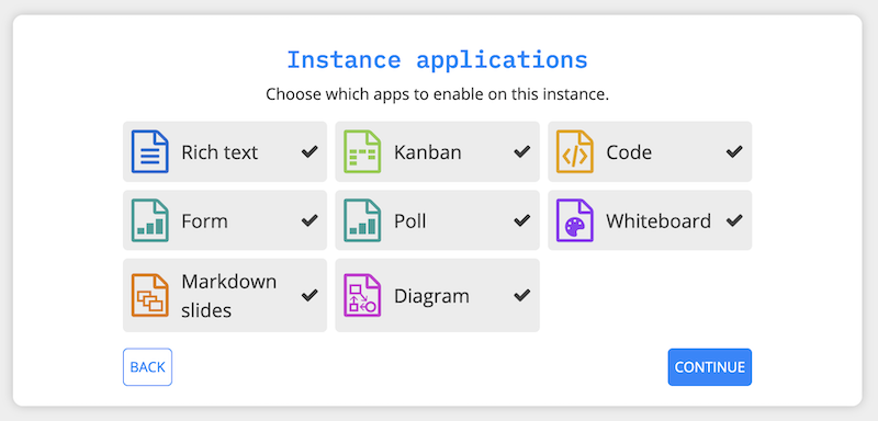

The next step is about chosing the applications to enable (all by default).
../_images/instance_setup_apps.png

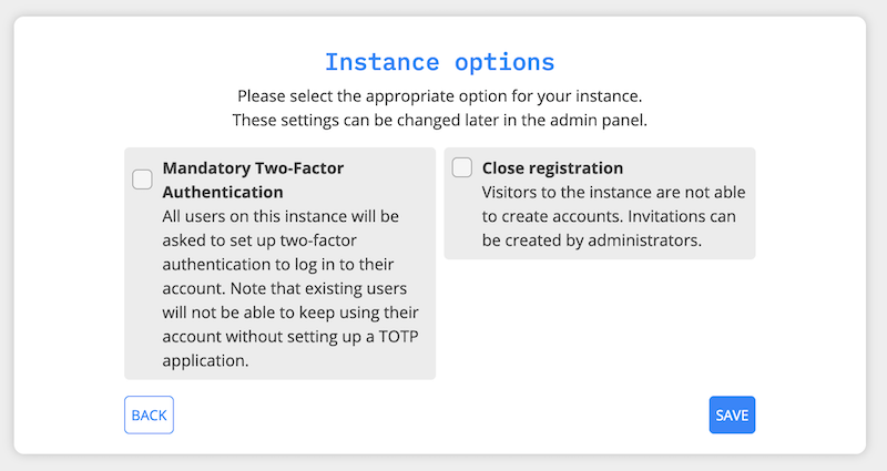

The last step let you enable two options:
  • Mandatory Two-Factor Authentication
  • Close registration
../_images/instance_setup_options.png
